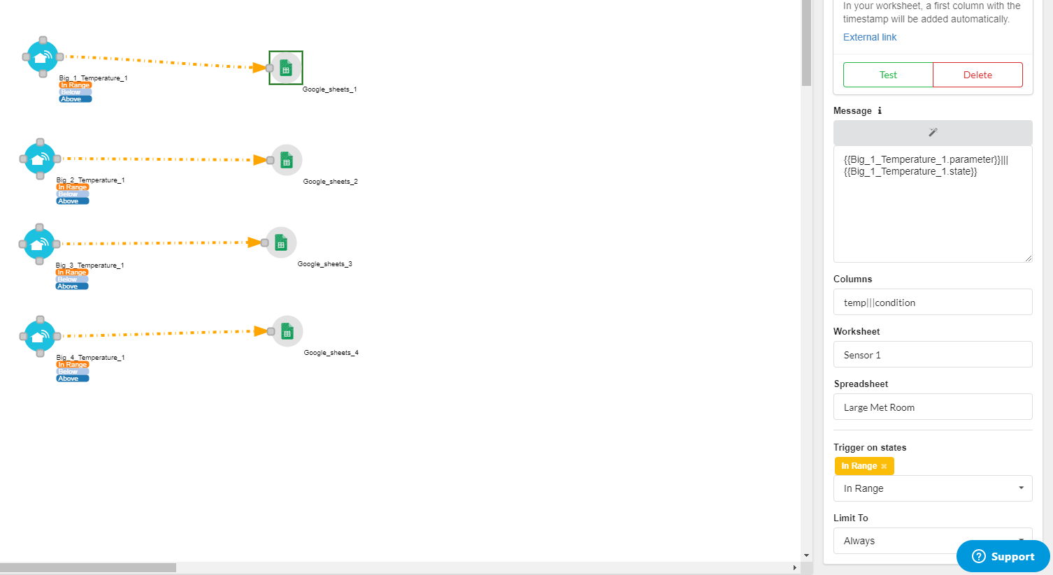

I've i have a setup just like described above, technoline temperature sensors, using conrad connect to record datasets in google sheets. Randomly, a new Spreadsheet is created in google sheets. i have many sheets with just 1 time slot recorded, others are days before a new one is made.
Hi @UonMMT, thanks for the update. I will ask the support team to test exactely this scenario. What sensors parameters do you use exactely (e.g. temperatur indoor vs. outdoor) and which hardware is employed?
Hi @UonMMT, may we kindly ask for a screenshot of the entire project?
Hi @UonMMT, please also indicate the type and model of your sensor.
Here's the image of the project, and the sensors are (Technoline Mobile Alerts MA-10001-UKSET)

Hi @UonMMT, thanks, but I still need to understand your problem better: 1) CC creates multiple Google Sheet files (were only one was supposed to be created, and 2) some sheets only contain one row of data (were multiples rows were supposed to be created), right?
