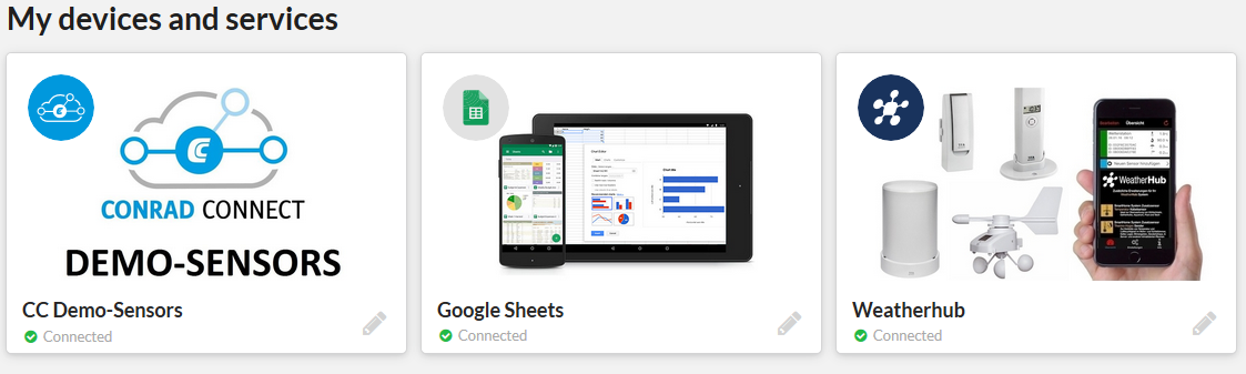

    Hi Christian,
    My Weatherhub device is well connected :

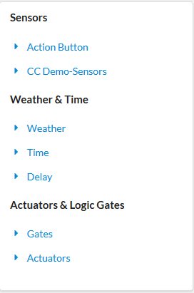

    But the Weatherhub does not appear on the left side on "My Project" :
    I thought that it was because of the incident.
    What did I miss ?

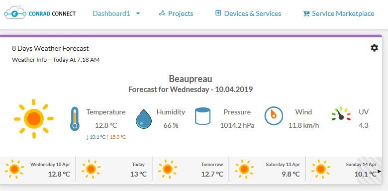

    Hi @Irvin, thanks for the details. May I ask if the Weatherhub sensor appears on the Dashboard? Just start a new dashboard and add the Weatherhub sensor(s) to it. Do you get meaningful readings displayed?
  • IrvinIrvin Member Posts: 14
    Hi Christian,
    No Weatherhub sensor on the dashboard :
    And I can't add it on the dashboard, I don't see it :

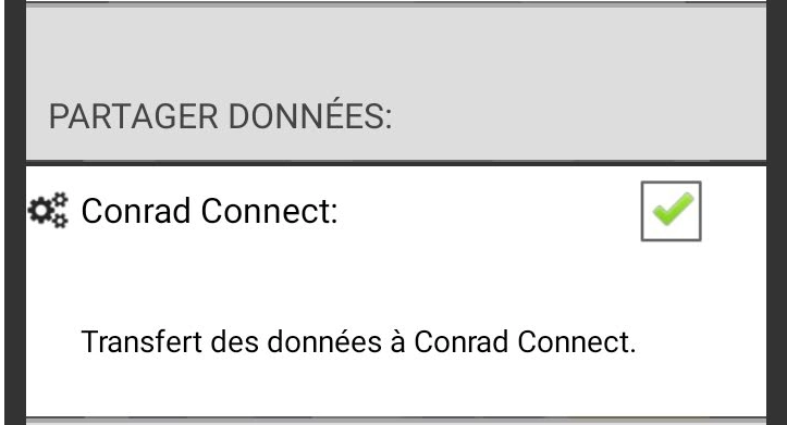

    @Irvin, did you activate in the weatherhub App settings the checkbox 'Conrad Connect' to allow data transfer to Conrad Connect?

    I allowed my weatherhub to send data to Conrad Connect :

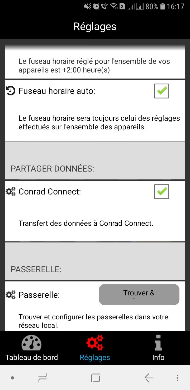

    Christian,
    Yes I activate "Conrad Connect" in the Weatherhub App :

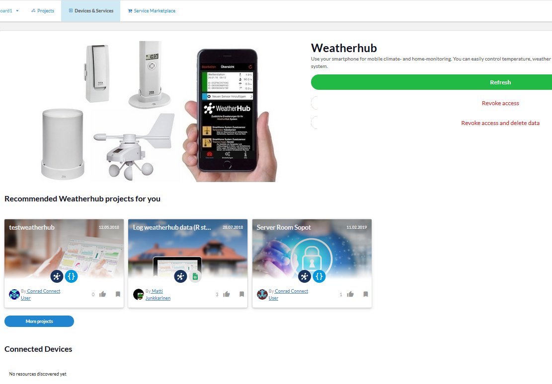

  • BerndBernd Member Posts: 23
    Please click on the 'Products and Services' page on 'Refresh'. Do you see connected devices (ressources) afterwards?:
    https://dashboard.conradconnect.de/devices/weatherhub
    Which devices (Model No) and device type did you connect?
    I think I was on a bad way, my device is BL-MA10000__Passerelle MOBILE-ALERTS. It is this device I have to connect, not a Weatherhub device.
    But with the Mobile-alerts it does not work too.
    It says "No resources discovered yet".
    I checked the phone ID, it seems to be the good one.
    Did someone connect MA10000 Mobile Alerts ?
  • ChristianChristian Administrator, Moderator Posts: 1,291 admin
    Hi @Irvin, my apologies, we couldn't help you so far. As for Mobile Alerts, please find compatible devices listed here.
    Hi @Irvin, the tech support team confirmed that the T303060 is not compatible with CC, the BL-MA10000__Passerelle, however, should most likely work.
