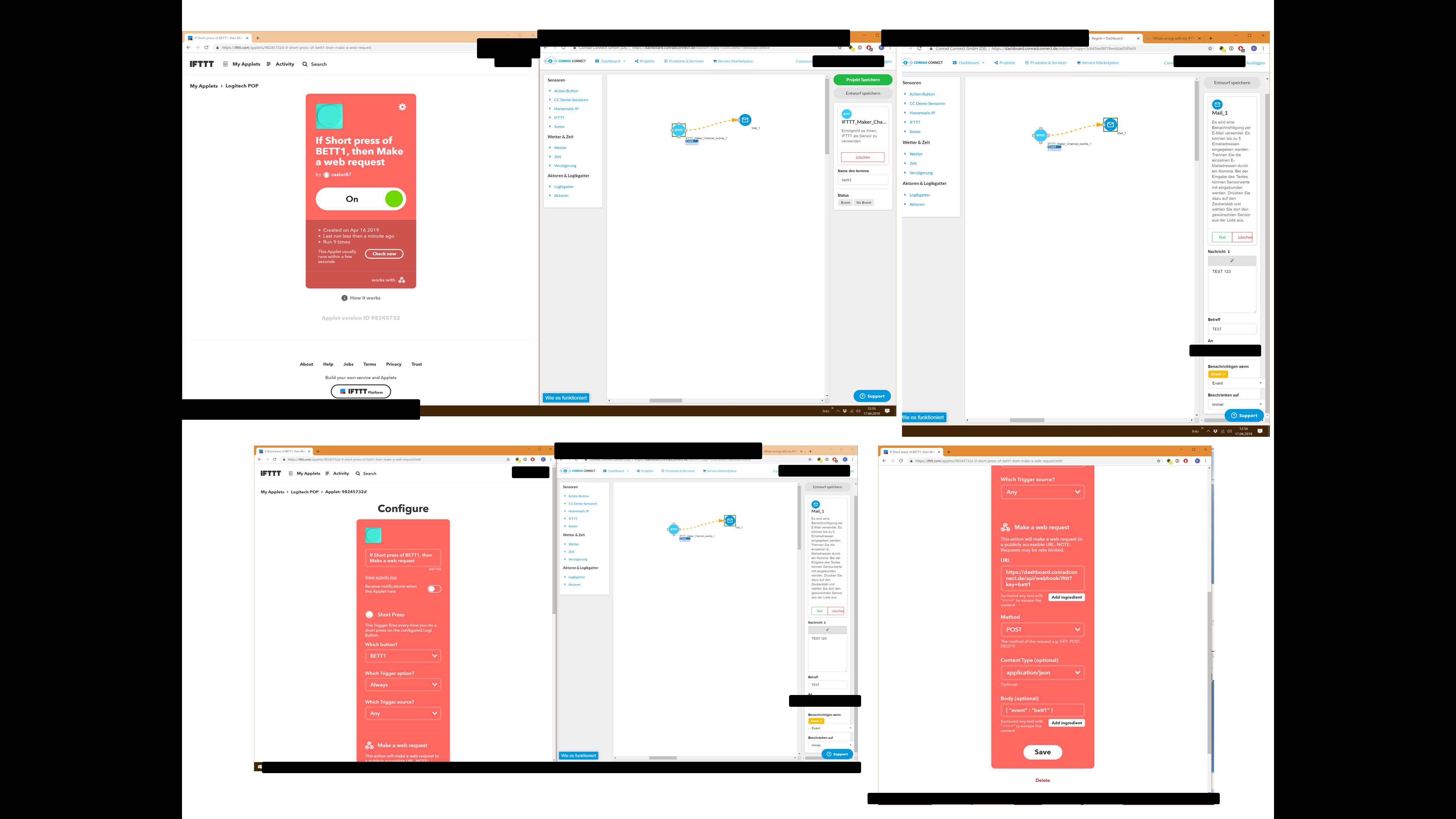

    Thanks for your quick response. I think, everything is correct, please see the screenshot. You see any mistake? THought, thats not too hard... ;-)

    The IFTTT works, you can see this at top left "las run less than a min ago", plus it appears at my IFTTT activity.
    Didnt get an email, besides when i click "test" within conrad connect.
    @Tom76 said:
    Looks to me that the key in the url in the IFTT applett is not the key which is needed here. In IFTTT the key has to be looked up in the Webhooks Service settings. This key is to be used in the URL after key=.
    Ok, makes sense, why it does not come through to conrad connect. Where / how do i find the correct key ?
