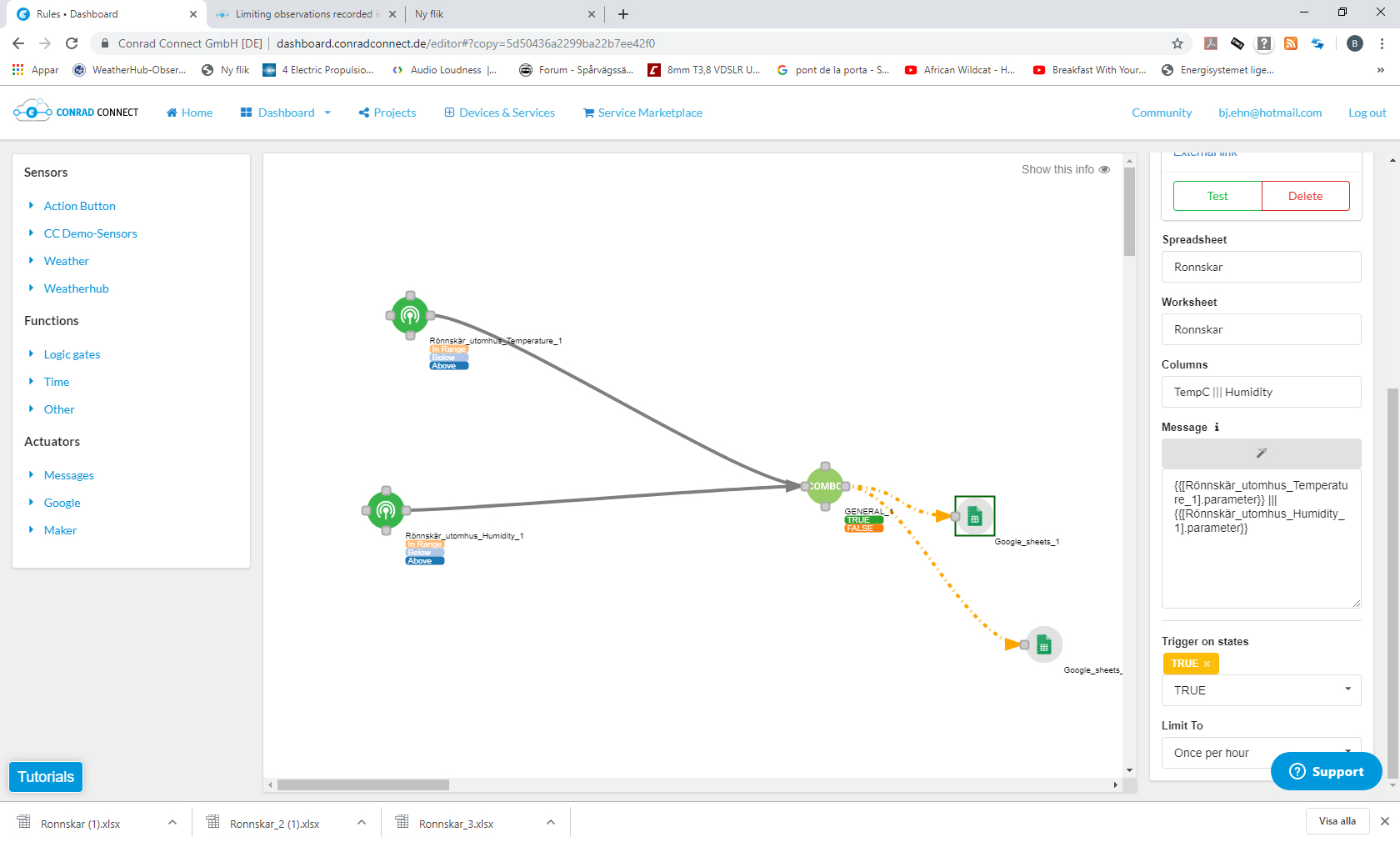

    I can't really say on who's side the problem is, but this is how I set up my project in order to monitor the phenomenon with lost actuator calls.
    Weather data (temperature an humidity) are fed into the project from two widgets in order to record the readings in two (in this case, normally just one sheet would be needed) Google spreadsheets.
    The upper actuator is limited to "once per hour", but the lower has the limit "always". As I understand it, this must be the most accurate way to set up a monitor track, due to the fact the two actuators share the same data feed.

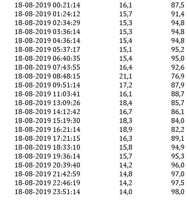

    The result from the upper actuator looks like this:

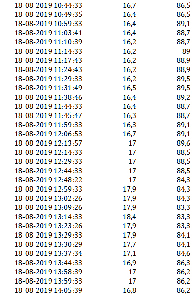

    Here we can easily see that there is a gap between 11:03:41 and 13:09:26. That's a period of more than 120 min. As I understand the limit "once per hour" the actuator should have been triggered at least once more during this interval.
    If we take a look at what is recorded by the lower actuator, we find a number of readings in between the times 11:03:41 and 13:09:26. It's very hard to understand the control flow in ConradConnect and what is really triggering the actuators, but in this case we have a number of data values in the data flow, and none of them have triggered the (upper) actuator the way I wanted it to be. This kind of glitch doesn't happen very often, not even during every 24 hour period.
  • bjehnbergbjehnberg Member Posts: 23
    Another peculiar thing that can be observed in the spreadsheet from the "once per hour" actuator, is that the point of execution is constantly pushed forward in time, and sometimes pushed "over the edge", for example 09:51:14 and then afterwards 11:03:41. This raises a question about the interpretation of the limit "once per hour". Is it one execution between '00 and '59 or is it one execution within a (~) 60 min. period, counted from the time of the last execution?
    edited August 2019
    Hi again, Christian, and thank you for your response.
