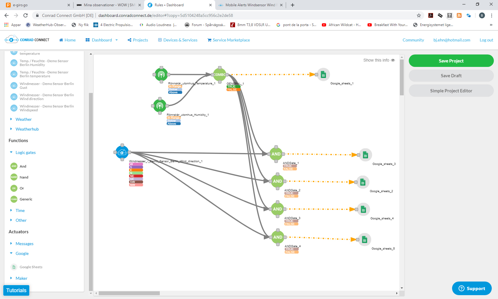

    Thanks a lot, Christian. One could express different opinions on how the wind direction widget is implemented, but given the fact that it is implemented as described, I tried a workaround which looks like this
    As you may see I have used a number of logic AND gates in order to sort out the different wind direction states of the wind direction widget. Every gate represents a certain state (i.e. a wind direction, in this case the cardinals N, E , S, W) and trigger a certain Google actuator with the wind direction expressed as a constant (letter N, E, S, W or the similar expressed in degrees) in the message (they all use the same spreadsheet and the same colums for this). Since the condition is AND they are all mutually exclusive, i.e. not more than one actuator can be triggered for a certain wind direction. Not a very elegant solution, but it should work. If you want to record any further weather data (or the intercardinals) in the same project you have to subscribe for the Enhanced Projects Premium Service, but that's just a financial problen, not a technical =) .
    But when I try to go live with this project it is rejected witht the message "Internal server error" . Why? I hav'nt got my own wind sensor installed yet, so in this case I used the Conrad demo sensor, but as I understand it, it should not make any difference.

    Hi @bjehnberg, first of all thanks for your patience testing so many things! I can disucss this case on Monday. What does the COMBO gate do exactely with the temperature and humidity data here? I am uncertain how these parameters help distinguishing the wind direction. Other than that, I suggest that you connect the output of all AND gates with one more OR gate which ultimately ends in one Google Sheet actuator. Please have a look here. In order to test whether this might solve your problem, please also remove the upper Google Sheets actuator temporarily.

    I knew you would ask me that question. The Humidity and temperature has nothing to do with the wind direction, it was only a tryout to create a realistic situation where I could be able to capture both wind driection and other weather data. Here are some further reflections:
    Pro primo: I must say, like Will Shakespeare, there is something rotten in the implementation of the wind direction widget. In the last setup I tried just a couple of minutes ago I used only one logic AND gate to test only one wind direction state (at the moment the setup was done the widget showed the state "S", so that's the value I used in my AND gate - the only choices you have in the gate, when connected to the wind direction widget, are the 8 cardinals and intercardinals). But when i try to save go live with the project, the error message "Node Windmesser_-_Demo_Sensor_Berlin_Wind_direction_1 [In Range, Below, Above] has no state S" is displayed (it doesn't matter which state I chose to test on, all available values in the AND gate give the same result) ????????
    Pro secundo: It would be extremely convenient if the wind direction widget could offer the actual wind direction not only as a state but also as a parameter. As this is'nt the case for the time being, the only way to get hold of the wind direction is the structure I sketched earlier, with one logic AND gate for every wind direction state, and the corresponding constant value i the message part of the actual actuator. These branches (for the different wind direction states) cannot be joined in an OR gate because in that case you won't be able to determine the wind direction state at all. Or am I thinking upside down here?
