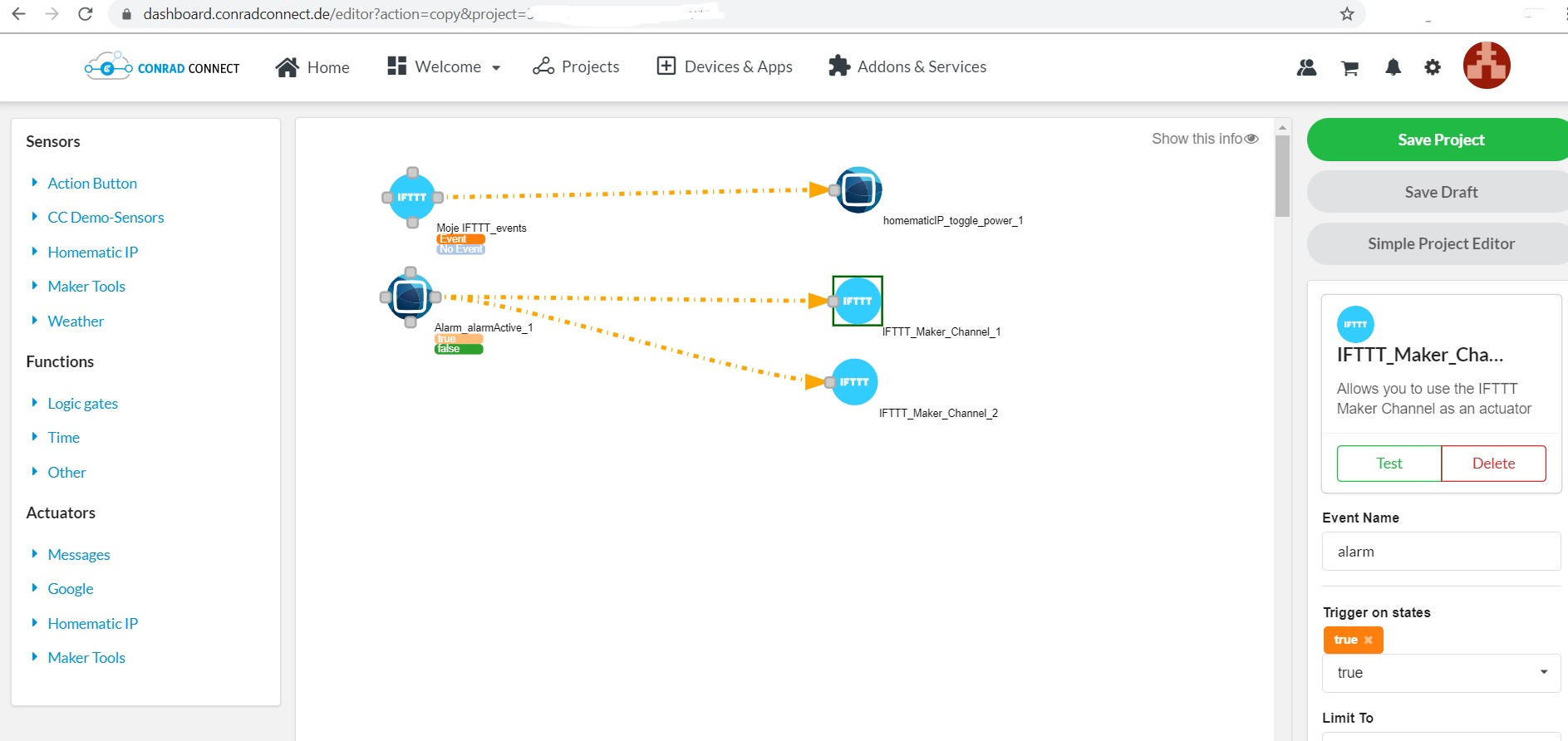

In CC the project has the IFTTT sensor connected to a time validation and connected to a IFTTT actuator.

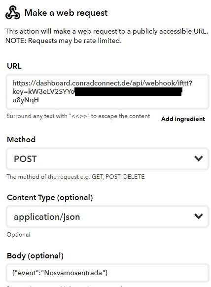

**IFTTT Applet which is trigger by google assistant, this applet it's supposed to call CC project:
**The CC project
As you see I also set a Pushover notification to test the CC project run, but I don't received any notification

In the screenshots attached i removed the time validation to make it simple even thought it don't work.

    Hi @nacho5000, sure, let's work it out. IFTTT related threads can be found here. I will be asking few questions first: 1) Is IFTTT connected to Conrad Connect? 2) Are there any unwanted space characters such as {" event":" event_xyz"}? 3) Are you 100% certain that the IFTTT applet - which itself triggers the Conrad Connect project - were running? IFTTT has counter for this. 4) Is your IFTTT Webhooks key still the same? A wrong click and IFTTT generates a new one.

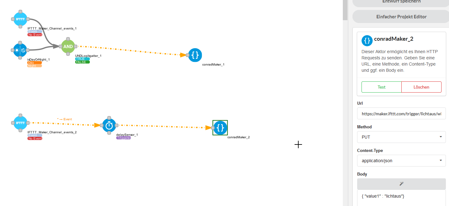

    This particular screenhot shows our Maker Actuator - it is not needed if you want to trigger Conrad Connect projects through IFTTT - our vice versa. We have a dedicated sensor and actuator just for IFTTT. Let me first please focus on this scenario: IFTTT triggers a project in Conrad Connect.
    1) It looks as if you have changed the IFTTT Webhooks key, right? I looked at the first and last screenshot of yours.
