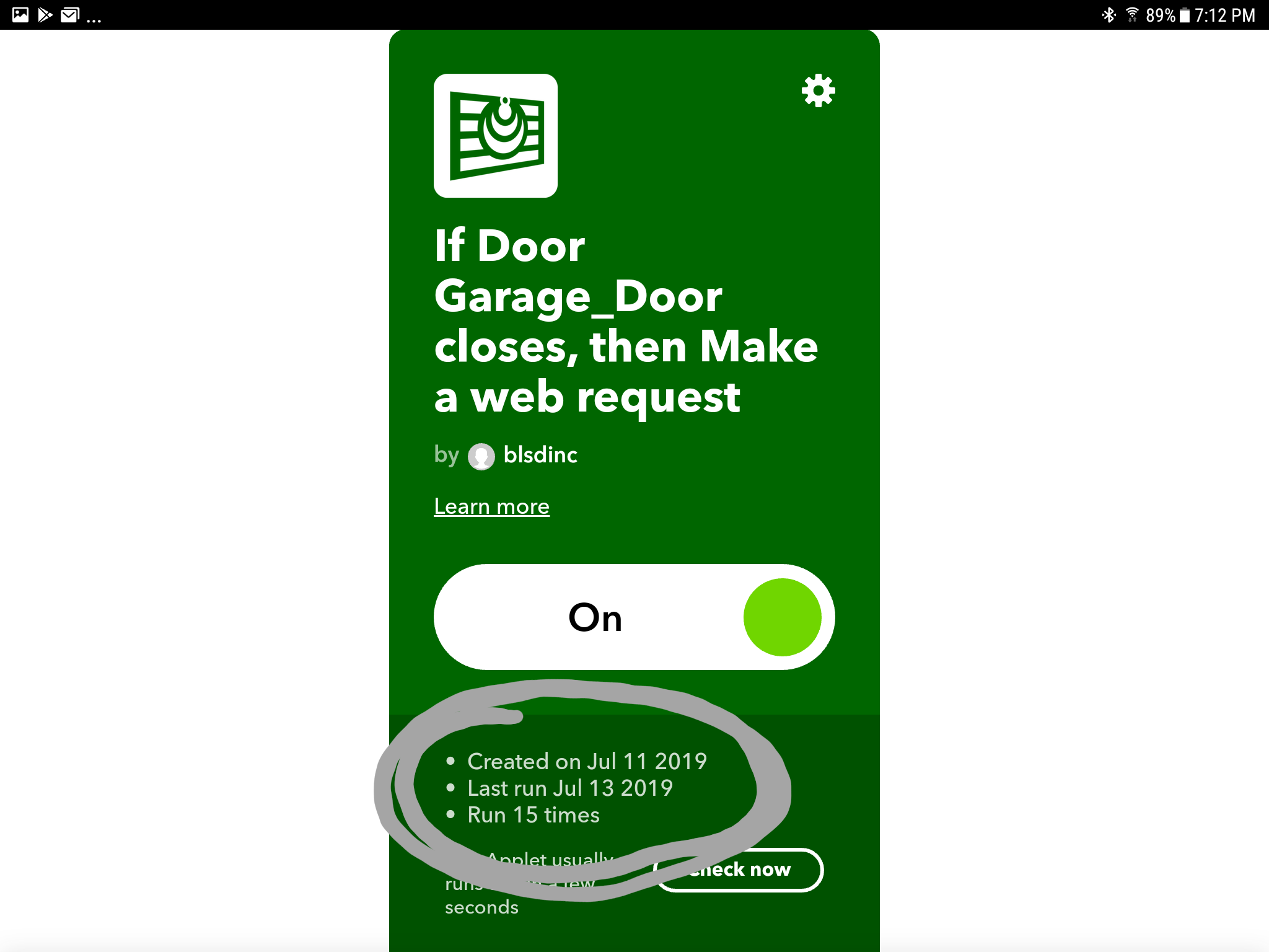

    Hi @ndesilva, good to know that it works with the Action button, so we can focus on the IFTTT part. As next steps, please do this: 1) Set up a new IFTTT Applet as such: "IF Door Closes, send me a text message", so we know for sure, that the sensor works in combination with IFTTT. 2) Next, please check here to see if the connection between CC and IFTTT is still established. 3) Now please check your [webhook settings] once again, click on Documentation, then verify the entire URL incl. the key. 4) As a last step, please post a screenshot of your entire IFTTT applet here (please grey out the key). I'll have a loook at it.
  • ndesilvandesilva Member Posts: 23
    Hi @Christian, I followed your steps:
    1) I created new IFTTT trigger to turn off the lights and that worked. So we know that when the Garage door closes it does trigger IFTTT correctly.
    2) Followed your link and refreshed the IFTTT connection in CC.
    3) I copied and pasted only the Key into the URL you provided earlier. See attached screenshot of the Applet.
    4) Attached. Bottom part of the IFTTT Applet is on my previous message. Sorry I can't get them all on one shot.

  • ChristianChristian Administrator, Moderator Posts: 1,869 admin
    edited July 14
    Hi @ndesilva, looks all good until here. Also, re-examing this part, all is fine (just verify that there are no unwanted space characters)
    Let me therefore now look at the IFTTT Maker Channel Event sensor:
    The setup looks right to me (again, please verify that there are no unwanted space characters).
    Is the subsequent actuator (or logical gate) set in a way that it listens to event?
    Let's please focus on getting a message actuator triggered for now, so this is our next step.
